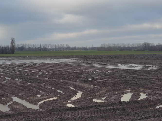

I’m by no means a farmer but past 3.5 years I live between farm land and this is my current view if I look outside the window
If you look at the big picture, all those black/white dots at the right field are geese. So far the nitrogen reduction by farmers :wink:
Some thoughts I would have as being a non-farmer but f.e. my grandfather was one would be these. And be aware that I’m quite a realist and some can confuse that with being negative but I do the same with my own ideas/concepts.
  • In The Netherlands (but currently as well in France/Germany/Belgium) there is a tremendous amount of regulations for farmers. While farmers got already more environmental friendly over the past 40 years (by lot of regulation) the current nitrogen crisis makes them furious. The thing is that they have their business for multiple generations and with the current EU policies they are afraid they have to quit. So many protests currently going on and not exactly a good climate to invest in equipment.
  • Contributing to the above is that supermarkets pay very little for products so the margins are under pressure. That’s also why Dutch meat for example gets exported while the meat we buy is from Argentina, so far environment.
  • As the picture shows, the next door river was high and The Netherlands is low so at this terrain it won’t do anything. No worries, they used 4 heavy tractors to pull one harvesting machine through it to get the sugar beets from the field. That being said, a lot of land in The Netherlands is clay. That sticks to the wheels/bands and those mudguards will be problematic I think. What they do here I noticed watching them is they have a steel tube running from the center of the wheel over the outside with some distance to literally slice the clay off before it gets stuck near the mudguards. It doesn’t look nice but especially with a tractor like this it can’t have one side stuck and going around in circles.
